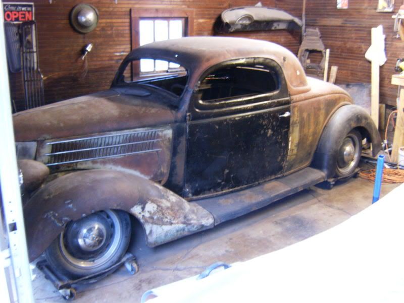

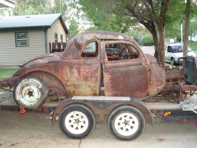

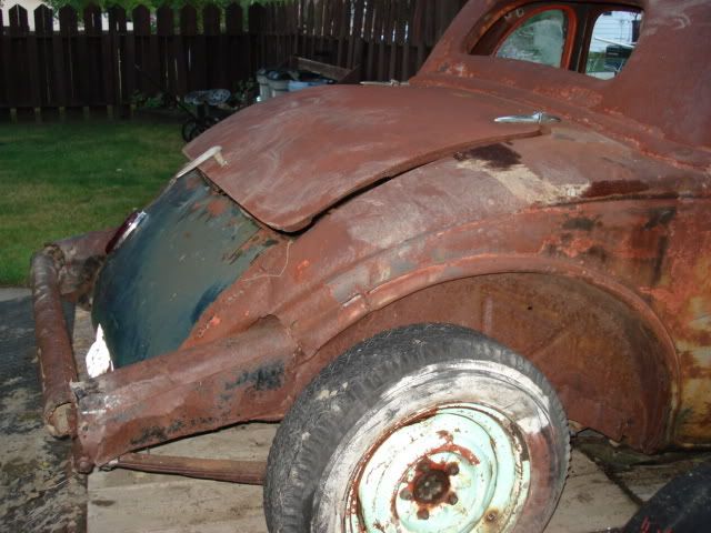

OK guys, here it is finally. I was dared to post pictures of the project by a pinstriper who shall remain nameless. I tried to document this build a little better than I have in the past, but then I lost most of the pics when my computer crashed anyway. This is what I started with, a '36 5-window that I bought from Serious, it was "customized" by a farm boy in the late 50's with the frame and drivetrain of a '50 ford, and futher customized by the boys at the Hazen town dump.

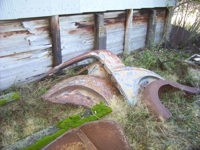

Heres the only pic to survive the crash, of the back end with all of the non-36 parts removed. In the pic you can see the deck lid fits pretty well, but its not 35/36 ford, its not even a ford of any year, no clue what it was for.

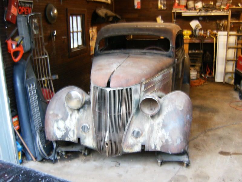

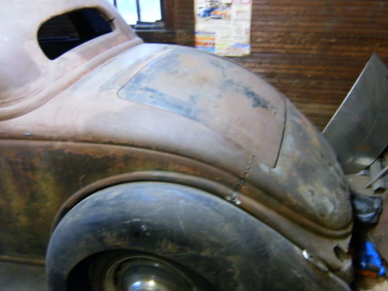

Here the car as it sits now.
You may notice the quarter windows are missing. I moved the back of the roof up 5", moved the door jambs back 6", chopped the top 3", and filled the roof, The doors are 2 door sedan doors, converted to 3 window doors using a really rusty 3 window door as a pattern. I cut up a very rough '35 2dr slant back to get the frame, dash, running boards and some floor pieces. The doors came from colorado, the cowl from sabin, the header from a diffrent guy in colorado, decklid from boston, tail section from indiana, rear fenders from thief river falls, and the front clip from fergus falls. Heres a couple other pics.

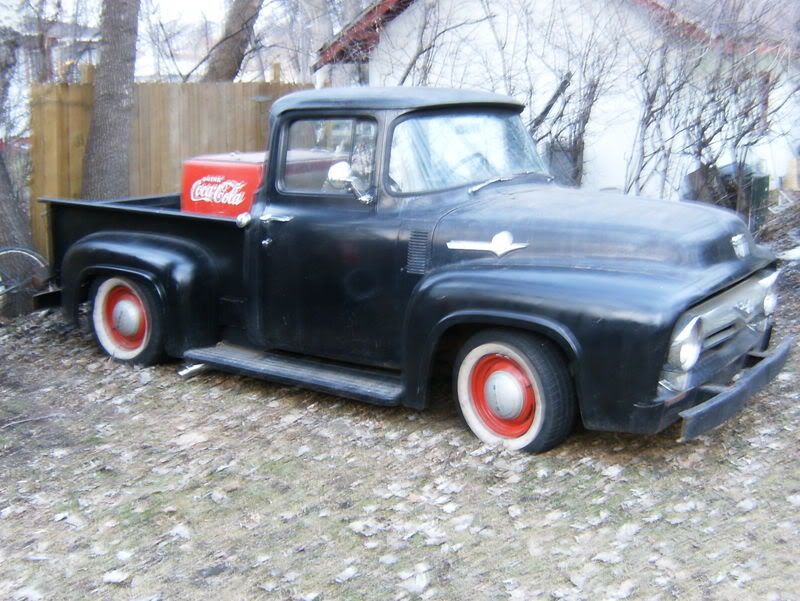

I thought I'd also include some pics include some pics of some(not all) the other irons I have in the fire that keep me from finishing anything. Frst is a '56 F100 big window, that started when I got a '55 shortbox frame from northcoastgreaser about 2 years ago. I was going to throw it together with parts left over from my other '56, but I think I ended up using 2 fenders and the running boards, and buying all diffrent stuff for this one. I'm hoping to have this on at BTTF's this year.

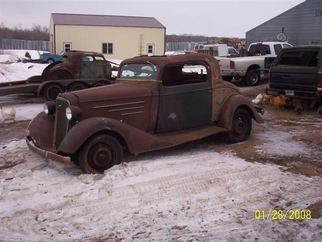

This is a '34 chevy 3 window. I started with these body halves I got from steve jorgenson for $100.
This is what it looked like when I put it together with a '34 Master 4dr. I got out of hazer's west yard.
I decided that it was way too much work for me, and that I had too many other cars to mess with so I sold it. I'll try to get updates when I can, but I have a few off topic cars to finish and sell so I can build a bigger garage, so who knows when that will be.    Matt

I didn't end up using the decklid that was on there. I sold it along with the 5 window doors and a '33 ford tudor body to the guy that bought the '34 chevy(he didn't know what the lid fit either, nor did anyone on the hamb) The really funny part, is that I bought a 36 deck lid along with the 2dr doors and the 3 window door, and the 36 decklid fit worse than the mystery lid. I thought something was really f'd up, until I bought ANOTHER 36 lid and it dropped on there like it was made for the car.
