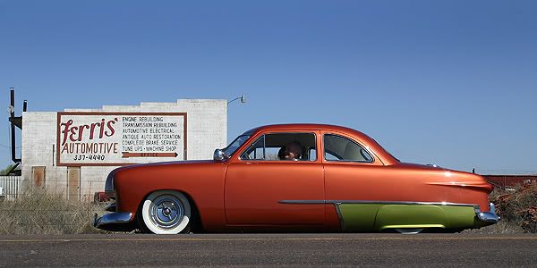

I stumbled across these trim ideas for the shoebox... I really haven't even thought about trim, and it will be a long time before I even think about changing the trim. But, as someone once said, "Damn if that don't look good!"... Opinions?
Pinstriper49's 49 Shoebox (Formerly SKOFORD'S)
« Reply #155 on: August 27, 2010 5:43 am »
Quote from: "pinstriper40"
I'll stick my foot in....I like the concept, but I think the real thing is too thick of a moulding. Looks kind of bulky on the real car versus the rendering.
Offline flatheaded
  • Posts: 217
« Reply #156 on: August 27, 2010 4:16 pm »
To be honest I kinda like the stock trim. Really simply and not too big like Jake said. Others that I am fond of are from '55-'56 Pontiac & shortened '59 Pontiac, '53 Buick (my favorite and on this years X-mas list), and '56 Chevrolet. One I came across not too long ago on the HAMB was the stock pieces off a '51 Ford but they replaced the piece right behind the door with a '57 Desoto down sweep and then continued with the wrap around pieces on the rear quarter and around the bottom of the trunk. I'll try and find some pics.

I had a older guy call me once for trim off a 55 chev fourdoor, he said years ago that was a real common choice for a shoebox, had to be fourdoor though...

I'll agree with you there Jake- the trim on the real car is about 1/2" too thick.  I do like the pontiac trim on shoeboxes too... I'll stick with stock trim for now.

I love the 55 Chevy trim on shoeboxes.
