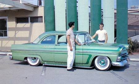

« Reply #28 on: April 16, 2009 10:29 pm »
I found this pic and am in love with the paint.
Photobucket
Wait, what the???
« Reply #29 on: April 17, 2009 12:06 am »
I like flames, but I have always loved scallops. For some reason they just seem to say 50's.
Keep up the progress Ryan.  :)
