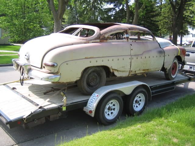

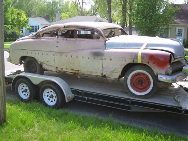

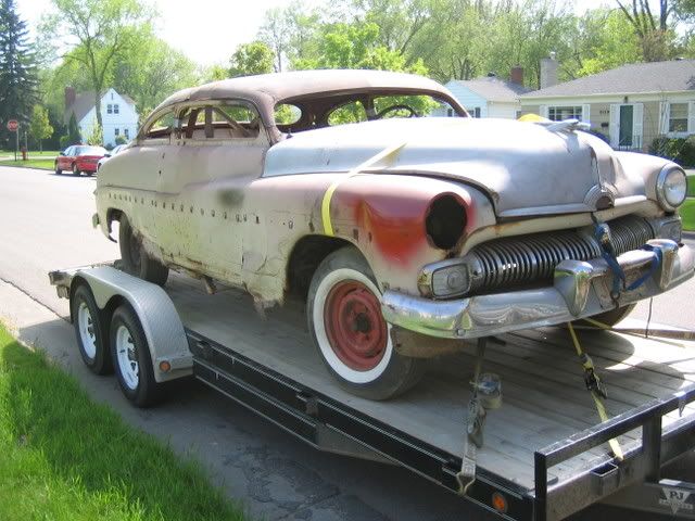

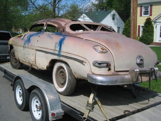

Here is what I started with. I first got my hands on this fairly solid 1951 4dr. Plans were for a chopped 4dr but once I found out that Dave's car was a former 4dr I couldn't resist the challenge. I found this hacked up 50 2dr on carsoup.com listed as a 1950 Ford. The A pillars are rusted away from the floor, this should give you an idea of the overall condition of this pos. However the doors were solid with a few rust pinholes on the passenger door and there are some dents to take care of but I had my doors. The spare coupe roof I stumbled on in MSRA's Line Chaser newsletter. This would have been a huge pain to do with out a good roof as you can see in the pics the "chopped" 2dr was cut with an ax and stick welded back together.

I apologize in advance for not having taken enough pics, you know how it is when you get on a roll and completely forget about the camera. I pulled the doors of the 2dr and cut the b pillars out along with the ¼ panel. I just cut back far enough so I knew it would cover the rear door opening on the 4dr body. I had the spare roof too that had the B pillar down to the belt line still in tact so I only cut it up to the belt line on the 2dr body.
The first thing to go was the B pillars on the 4dr body. Then I hung and adjusted the doors so they worked properly. The next step was easier than I thought. I started trimming up the B pillar/ quarter panel sections to fill the gap where the rear doors use to be. There is a stud on the upper most forward part of the lower fenders that hold it on to the body. To my surprise there is a hole on the 2dr ¼ where there is a brace bolted on that is in the exact same location. (hope that made sense) So I trimmed it up and slid the ¼ over the stud and the B pillar was located just like that. The passenger side did require me to slot the hole and move the pillar about 1/8" forward to get a nice door gap.  At this point I tacked the B pillar in and check to see if the door would open a close fine. I still had the extra metal overlapping on the ¼ so I just took the cut off wheel on the grinder and slowly ran it down the line where the rear door opening was. Then I tacked it in place and made a few more tacks on the B pillar to the floor to keep it in place. I didn't want to make anything too permanent until I switched roofs.

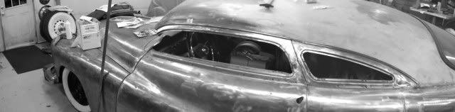

Last night I finished tacking in place the "patch" panels that I made buy cutting apart the rear doors. The donor 2dr had rusted and creased metal that I had tacked in place in the earlier photos.

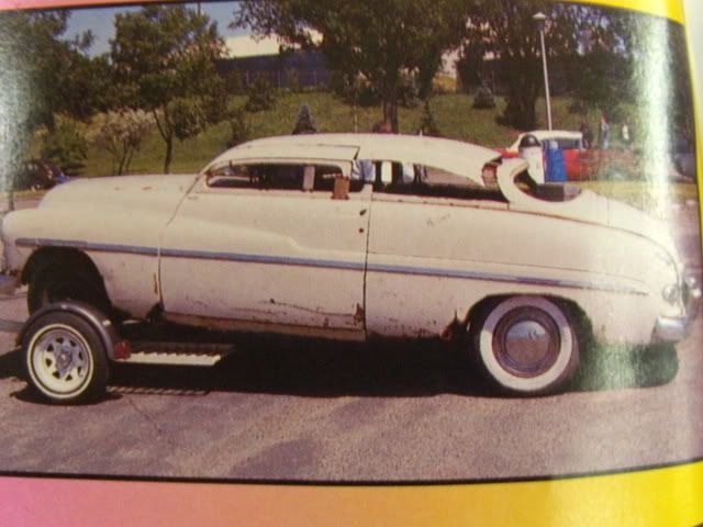

Last night I was in the garage trying to decide what to do next. I started to dust of the Merc and look at the passenger door to see where I left off on it a few years ago. I decided I needed a little inspiration. When I was in Bismarck for the rod run there was a pile of old R&C and Custom Rodder mags they were giving away and I pulled all the Custom Rodders I could get my hands on. So I pulled them out last night to look through them for said inspiration. I found this pic in the first one I opened up.
This was the fall 1993 issue and as you can see it has event coverage of the 19th Annual BTT50’s. The heavy chop on the Merc caught my eye. Then I thought……..wait one damn minute that is the Merc I cut up to convert mine into a 2dr! I picked it up in the summer of 2005 and you can tell some more of the great body work had been completed by the time I got it and they also ripped off all the trim which is now a twisted up mess still laying in the car. They also laid down some grey primer on the hood and put the ¼ windows in. Check out the long scratch/gouge in the driver’s door.
I used the doors, b pillars, part of the rear ¼ below the ¼ windows and the grill opening off the car.

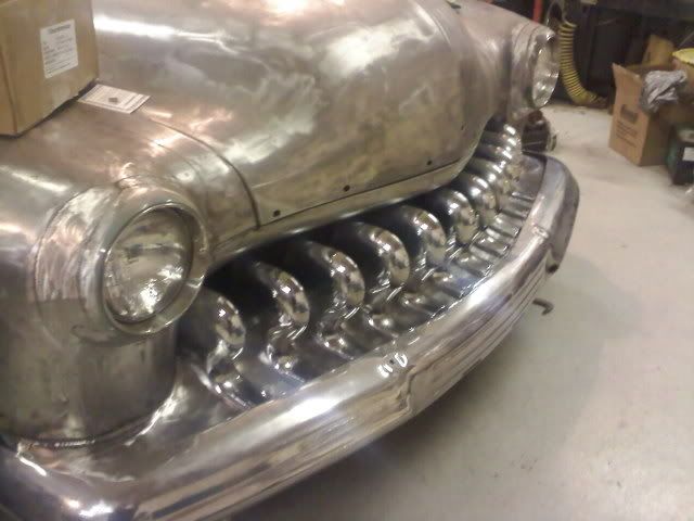

Last week I finished up installing the grill which involved combining the Merc and Desoto gravel pans and then reshaping the end teeth so they would fit. I was going to re space the teeth so they were all closer together to get them to fit back in the opening but they just looked too crowded. The pan is now welded in place and the mud slinging can begin.
