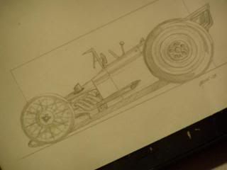

heres a sketch i did a while ago just to give y'all an idea of what i'm considering building.  its pretty much what i'd do, with exception to the front suspension and the wheelbase would be a little longer in rear.
what do ya think?
-ncg
