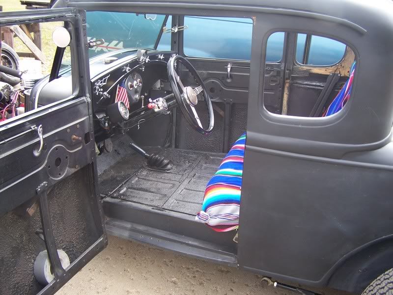

Well, I just got it home this weekend, and with the help of Mr. Eyeball, we got it off of the trailer and into the shop.  plans include a 3" chop if I still fit after the 3" channel.  It'll have an early flathead with aluminum stuff on it eventually.  3 speed toploader trans, banjo rear.  I've got a '37 I beam and wishbone that will be split soon, and am looking for front brakes.... :wink: the frame will be z'd 5" in the rear and pie cut up front via mad fab. vol. 4.  Possible cowl steering, '40 column and wheel, sun 5000 RPM tach, and I don't know what for a guage panel yet. I've got a '37 harley "skull" gauge pod I might use.  Check out the wanteds for my shopping list!

Don't do the channel than you CAN do the chop.

I'll side with Tom.  Don't channel it.  I used to put a lot of miles on the "Jakester" (It was channeled 4".) and it got real old resting your chin on your knees.  And I think you have some pretty long legs! I could only go about an hour and a half and have to stop and walk around a while to loosen up. I'd never channel another "A". My 2 cents.

since it does have a floor in it, it makes sense not to channel it i guess.  I'll still have to take the floor in the back out to get the rearend up in there.  You're right jake, just with a chop my head and legs will be pissed at me enough.  It would be nice to be able to drive it!

Striper...you should build it how you want.  I was just relaying my experience.  If you have a nice subframe and want to "feel" the channeled effect, a quick raised floor can be made from some scrap 2x4s and plywood and set on top of your subframe to see how it feels. In a coupe you have room to move the seat rearward farther than a rpu.  I always wished I had stretched the body another 3 inches, but it would have changed the "look" I was after.....just like your original thought. We're always after "the look" and sometimes suffer in the "feel".

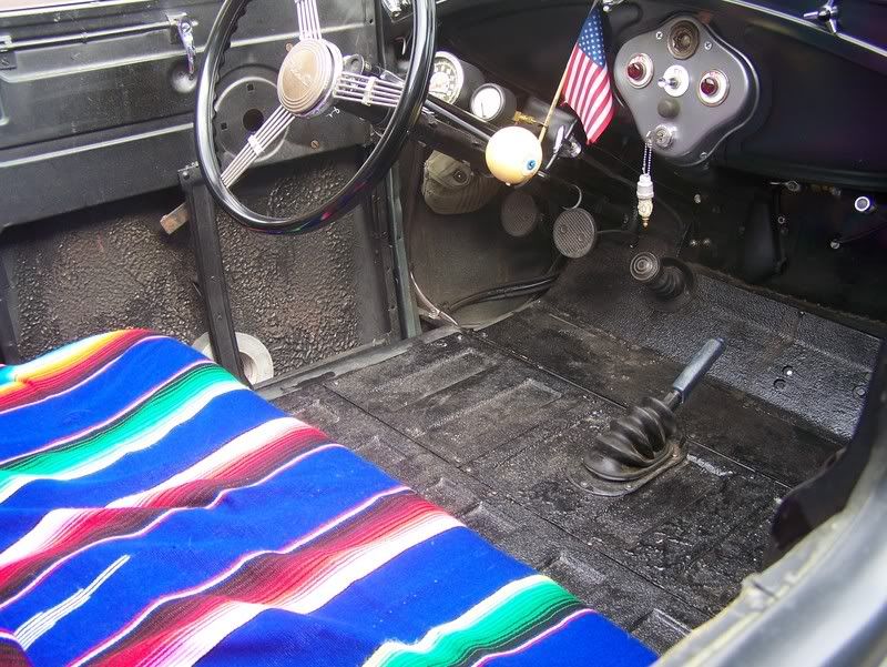

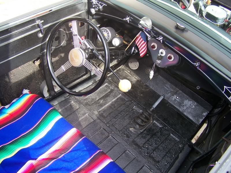

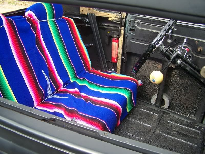

Todd Jake and I have the perfect "A" seat.  85-7 Dodge colt Vista van very back rear seat (38 in wide).  I have mine on modified 80 suburban seat tracks for the front ot back adjustment.  The seat backs recline by "clicks" at different angles or lay down on the cushion ( in case you want to haul 2x4's sticking out thru the deck lid).  I have mine all the way to the back window (take out the stock package shelf), car is channelled 4 1/2 in front about 4in rear and chopped 3 in (that's the LOOK I was after).   My 6'3" son whines about it being cramped, at 5' 10" I'm good.  You'll need a "traffic light viewer".  Hey--it's a little car not a Cadillac.  My legroom is OK, column shift helps for room, cowl steering would help, too.

Yes, that was a nice seat.  Thanks to Reed for hooking me up with one. Unfortunately I had it stored in the attic right above my shop furnace that malfunctioned two years ago. What was left of it is now buried at the land fill.
It was a good seat for an "A" or similar sized car.  Could easily be trimmed in many ways.  I liked that each backrest was adjustable.

Well there's a couple ways to measure.  How long from your ass to your head or your ass to your feet?  Do like Jake said and mock up a seat (way back) and check it at different heights.  Try on Todd's or my coupe for size.  Channel 3 in in front and 2 1/2 in back.  Chop 2/1/2 and call it 3in. (The gospel according to Dave Boardman)  Model A's and T's are so easy to channel.  Build ass buckets or cutouts in the seat cushion to lower your butt for headroom. Smaller diameter steering wheel and short column.  I spent a lot of time figuring and sizing up my coupe to fit more than just me.  My kids whine, but they can drive it and enjoy it.  The smiles on their faces tell me it still fits a 6' 3" person.  I think my model A is the roughest riding car i've owned (that's called complaining), but I've never had as much fun with another car. Soooo- Last resort--cut your feet off.
