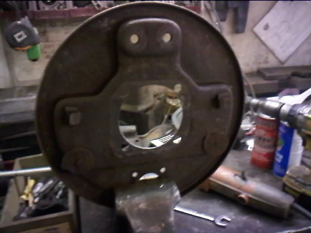

Here is what they looked like before.

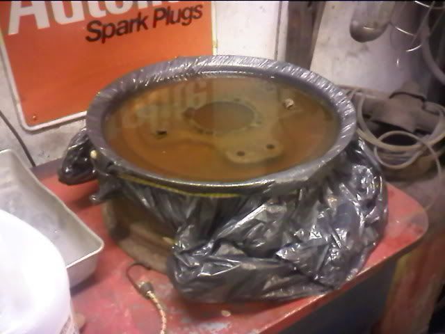

I could not find a bucket that was big enough for the plates so I used a wheel with a garbage bag in it. I just used a bungee cord to hold it in place. I soaded them for 3 days.

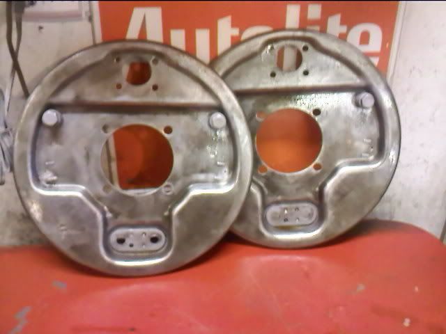

And here is what they look like after I took them out and hit them with a wire brush on the grinder.
TECH Post Vinegar
« Reply #27 on: December 29, 2008 10:32 pm »
that is a good example of how well the vinegar works.
nice idea too for making a tank to put the backing plates in
TECH Post Vinegar
« Reply #28 on: December 30, 2008 12:40 am »
Great engenuity with the wheel trick!  Looks like it worked good. Smells like crap though.  Are those for the Merc?
